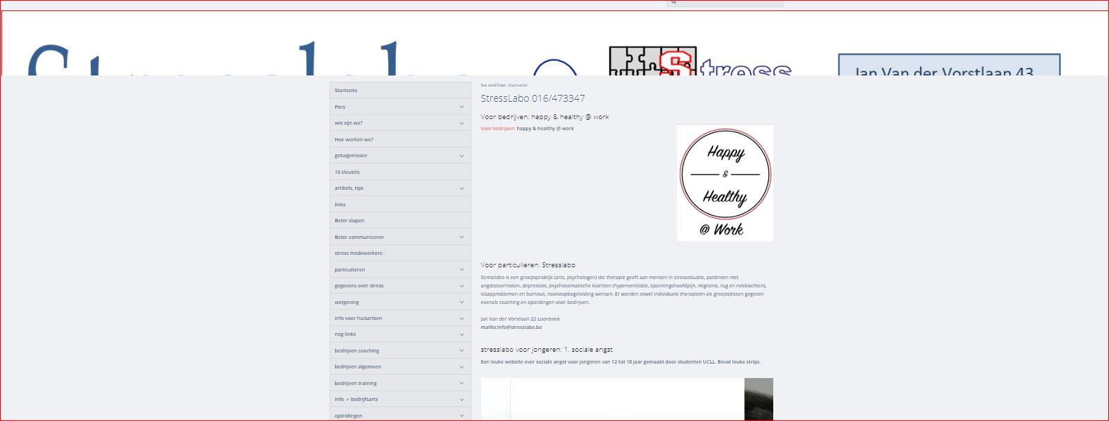

With stresslabo.be , where i used web 10, responsive design Washington, I see a more fragile behavior. I tested it on 4 computers, I tried IE, I also tried the NewYork design, I started over with several empty projects. The responsiveness is different. I only see the complete menu with chrome when I zoom out to 90%, and the menu disappears when I diminish the window by a little. (In terms of bootstrap: the breakpoint to hide the menu is too big, too much to the right.
Your message helps. I checked one computer and noticed that the fontsize was changed to 141%. perhaps this can be a cause.
You can imagine I was a bit frustated in the beginning because NewYork and Washington design nearly always hide the menu.
I noticed another strange when zooming out with Washington: the complete content area shrinks in a complete different way than with bootstrap.  Capture.JPG
I zoomed out very much so you can see the effect clearly. If I did the same with www.rcoz.be (bootstrap), the content still filled the complete width.
